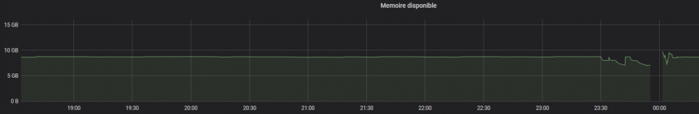

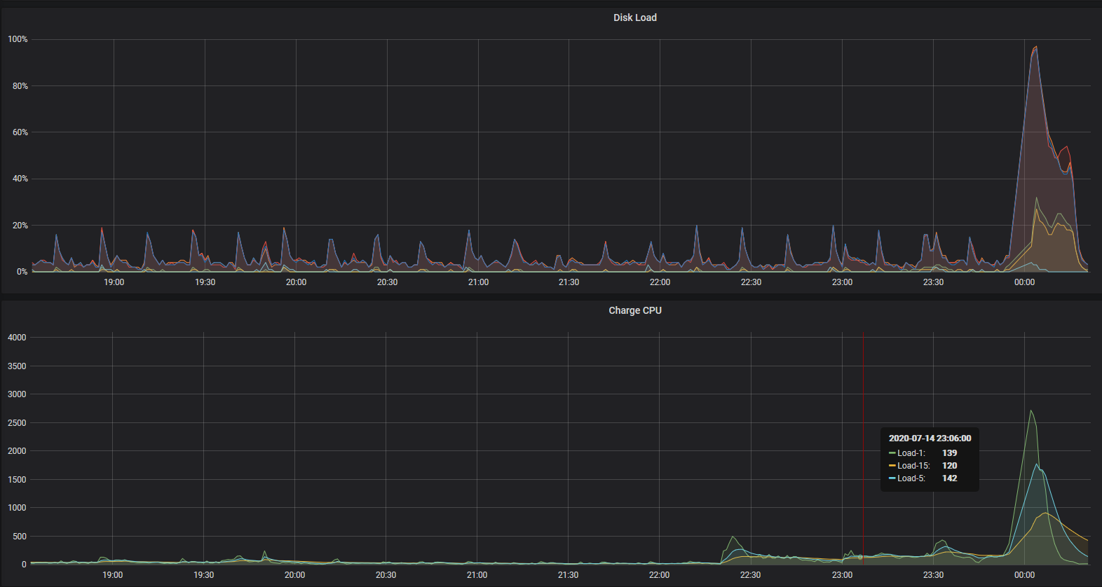

Merci @.Shad., dmesg -T donne le résultat suivant, mais le reboot est déjà en route ! on ne voit pas ce qui se passe juste avant : [Tue Jul 14 23:56:07 2020] Initializing cgroup subsys cpuset [Tue Jul 14 23:56:07 2020] Initializing cgroup subsys cpu [Tue Jul 14 23:56:07 2020] Initializing cgroup subsys cpuacct [Tue Jul 14 23:56:07 2020] Linux version 4.4.59+ (root@build3) (gcc version 4.9.3 20150311 (prerelease) (crosstool-NG 1.20.0) ) #25426 SMP PREEMPT Tue May 12 04:54:55 CST 2020 [Tue Jul 14 23:56:07 2020] Command line: root=/dev/md0 earlyprintk=apl console=ttyS2,115200n8 ihd_num=4 netif_num=2 HddHotplug=1 SataPortMap=23 sata_remap=0>2:1>3:2>0:3>1 syno_hw_version=DS918+ vender_format_version=2 syno_hdd_detect=18,179,176,175 syno_hdd_enable=21,20,19,9 syno_usb_vbus_gpio=13@0000:00:15.0@1,11@0000:00:15.0@2 sn=xxxxxxxxxx macs=xxxxxxxxxx,xxxxxxxxxx [Tue Jul 14 23:56:07 2020] KERNEL supported cpus: [Tue Jul 14 23:56:07 2020] Intel GenuineIntel [Tue Jul 14 23:56:07 2020] x86/fpu: xstate_offset[3]: 960, xstate_sizes[3]: 64 [Tue Jul 14 23:56:07 2020] x86/fpu: xstate_offset[4]: 1024, xstate_sizes[4]: 64 [Tue Jul 14 23:56:07 2020] x86/fpu: Supporting XSAVE feature 0x01: 'x87 floating point registers' [Tue Jul 14 23:56:07 2020] x86/fpu: Supporting XSAVE feature 0x02: 'SSE registers' [Tue Jul 14 23:56:07 2020] x86/fpu: Supporting XSAVE feature 0x08: 'MPX bounds registers' [Tue Jul 14 23:56:07 2020] x86/fpu: Supporting XSAVE feature 0x10: 'MPX CSR' [Tue Jul 14 23:56:07 2020] x86/fpu: Enabled xstate features 0x1b, context size is 1088 bytes, using 'standard' format. [Tue Jul 14 23:56:07 2020] e820: BIOS-provided physical RAM map: [Tue Jul 14 23:56:07 2020] BIOS-e820: [mem 0x0000000000000000-0x0000000000057fff] usable [Tue Jul 14 23:56:07 2020] BIOS-e820: [mem 0x0000000000058000-0x0000000000058fff] reserved [Tue Jul 14 23:56:07 2020] BIOS-e820: [mem 0x0000000000059000-0x0000000000085fff] usable [Tue Jul 14 23:56:07 2020] BIOS-e820: [mem 0x0000000000086000-0x00000000000fffff] reserved [Tue Jul 14 23:56:07 2020] BIOS-e820: [mem 0x0000000000100000-0x000000000fffffff] usable [Tue Jul 14 23:56:07 2020] BIOS-e820: [mem 0x0000000010000000-0x0000000012150fff] reserved [Tue Jul 14 23:56:07 2020] BIOS-e820: [mem 0x0000000012151000-0x0000000067c17fff] usable J'ai ouvert un ticket de support, et j'ai eu comme réponse un "plantage de la Virtualization / kvm", sans autre forme de procès ... : "kernel panic caused by kvm functions" A priori j'ai retrouvé une situation stable et saine, et je ne pense pas avoir perdu de données malgré le vidage des caches NVME. Je vais continuer à surveiller de prêt. Cdt Bruno78 -

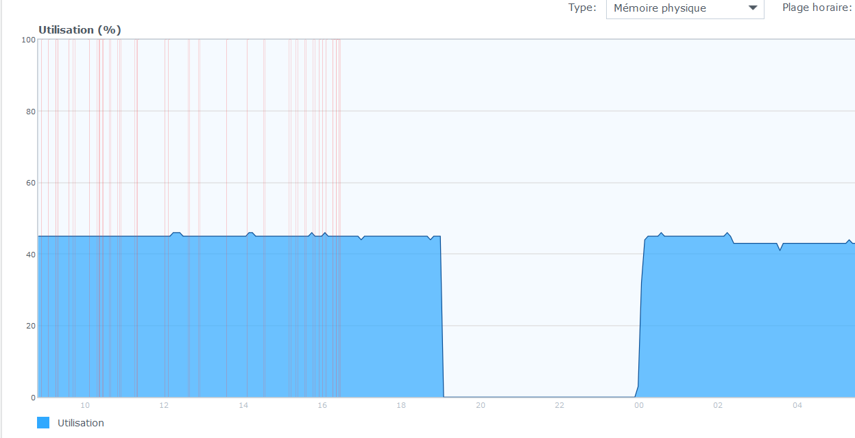

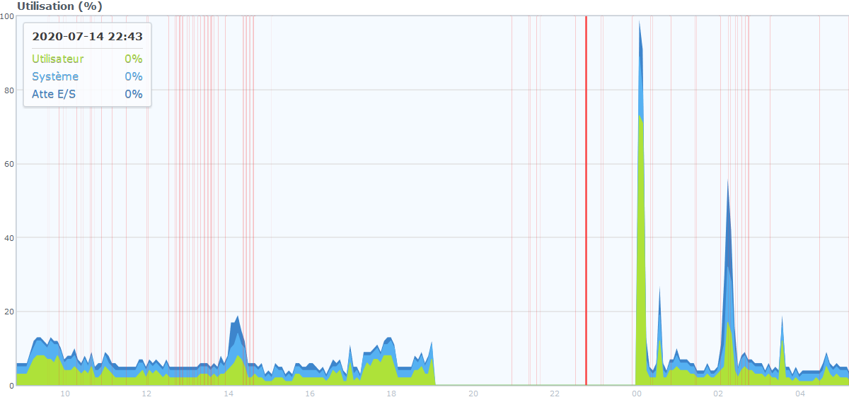

Bonjour, sur le /var/log/message : il ne se passe rien à 1900 : entre 13:42 et 19:48, rien. A 19:48 c'est le VPN qui redemarre (après 24h). 2020-07-14T13:42:01+02:00 ds918blam synoupgrade_SYNO.Core.Upgrade.Server_2_check[20303]: updatechecker.cpp:69 synoinstall: Failed to get security json 2020-07-14T13:42:01+02:00 ds918blam synoupgrade_SYNO.Core.Upgrade.Server_2_check[20303]: updatechecker.cpp:224 synoinstall: Failed to get parser 2020-07-14T19:48:58+02:00 ds918blam synovpnc: connection.c:1530 SLIBCSzHashGetValue(ds_dns) failed 2020-07-14T19:48:58+02:00 ds918blam synonetd: base_hook.cpp:74 Hook environment is not valid 2020-07-14T19:48:58+02:00 ds918blam synovpnc: connection.c:246 Fail to get interface info. 2020-07-14T19:48:58+02:00 ds918blam openvpn[1736]: WARNING: file '/tmp/ovpn_client_up' is group or others accessible 2020-07-14T19:48:58+02:00 ds918blam openvpn[1739]: NOTE: the current --script-security setting may allow this configuration to call user-defined scripts ensuite à 23:57:37 c'est le reboot alors que l'antivirus a demarré quelques minutes plus tôt 2020-07-14T19:49:15+02:00 ds918blam synomustache: synomustache.cpp:88 Failed to load /var/packages/Spreadsheet/target/etc/Spreadsheet.mustache [No such file or directory] 2020-07-14T19:49:15+02:00 ds918blam synomustache: synomustache.cpp:88 Failed to load /var/packages/Spreadsheet/target/etc/Spreadsheet.mustache [No such file or directory] 2020-07-14T19:49:17+02:00 ds918blam synomustache: SYSTEM: Last message 'synomustache.cpp:88 ' repeated 1 times, suppressed by syslog-ng on ds918blam 2020-07-14T19:49:17+02:00 ds918blam [3302117.064932] init: scsi_plugin_server main process (6343) killed by TERM signal 2020-07-14T19:57:08+02:00 ds918blam [3302588.061774] init: synoscheduler-vmtouch main process (12602) killed by TERM signal 2020-07-14T23:41:59+02:00 ds918blam synoavscan: synoav_engine.c:122 Initialize engine with 25873 2020-07-14T23:52:57+02:00 ds918blam synoavscan: synoav_engine.c:122 Initialize engine with 25873 2020-07-14T23:57:37+02:00 ds918blam kernel: [ 0.000000] ACPI: RSDP 0x000000007AFFE014 000024 (v02 INSYDE) 2020-07-14T23:57:37+02:00 ds918blam kernel: [ 0.000000] ACPI: XSDT 0x000000007AFDA188 0000DC (v01 INSYDE INSYDE 00000003 01000013) 2020-07-14T23:57:37+02:00 ds918blam kernel: [ 0.000000] ACPI: FACP 0x000000007AFF5000 000114 (v06 INSYDE INSYDE 00000003 ACPI 00040000) 2020-07-14T23:57:37+02:00 ds918blam kernel: [ 0.000000] ACPI: DSDT 0x000000007AFE6000 00772B (v02 INSYDE INSYDE 00000003 ACPI 00040000) 2020-07-14T23:57:37+02:00 ds918blam kernel: [ 0.000000] ACPI: FACS 0x000000007AFAF000 000040 2020-07-14T23:57:37+02:00 ds918blam kernel: [ 0.000000] ACPI: FACS 0x000000007AFAF000 000040 2020-07-14T23:57:37+02:00 ds918blam kernel: SYSTEM: Last message '[ 0.000000] ACPI:' repeated 1 times, suppressed by syslog-ng on ds918blam 2020-07-14T23:57:37+02:00 ds918blam kernel: [ 0.000000] ACPI: UEFI 0x000000007AFFD000 000236 (v01 INSYDE INSYDE 00000001 ACPI 00040000) 2020-07-14T23:57:37+02:00 ds918blam kernel: [ 0.000000] ACPI: BDAT 0x000000007AFFB000 000030 (v02 INSYDE INSYDE 00000000 ACPI 00040000) 2020-07-14T23:57:37+02:00 ds918blam kernel: [ 0.000000] ACPI: UEFI 0x000000007AFFA000 000042 (v01 INSYDE INSYDE 00000002 ACPI 00040000) 2020-07-14T23:57:37+02:00 ds918blam kernel: [ 0.000000] ACPI: SSDT 0x000000007AFF9000 000554 (v01 INSYDE Tpm2Tabl 00001000 ACPI 00040000) 2020-07-14T23:57:37+02:00 ds918blam kernel: [ 0.000000] ACPI: TPM2 0x000000007AFF8000 000034 (v03 INSYDE INSYDE 00000002 ACPI 00040000) -

Bonjour, 27557 0 -rw-r--r-- 1 root root 0 Jul 15 00:57 dmesg 28746 52 -rw-r--r-- 1 root root 49864 Jul 14 23:58 dmesg.1.xz dmesg est vide, tandis que les fichiers dmesg.{1,2,3,4}.xz sont illisibles. Quant à /var/log/syslog.log : (l'IP du NAS est 192.168.1.171) 2020-07-14T09:51:43+02:00 ds918blam syslog-ng[4665]: Configuration reload request received, reloading configuration; 2020-07-14T21:55:02+02:00 ds918blam syslog-ng[4665]: Configuration reload request received, reloading configuration; 2020-07-14T23:57:37+02:00 ds918blam syslog-ng[4727]: syslog-ng starting up; version='3.7.3' 2020-07-14T23:57:46+02:00 ds918blam syslog-ng[4727]: Connection failed; fd='33', server='AF_UNIX(/var/run/synologan.sock)', local='AF_UNIX(anonymous)', error='No such file or directory (2)' 2020-07-14T23:57:46+02:00 ds918blam syslog-ng[4727]: Initiating connection failed, reconnecting; time_reopen='10' 2020-07-14T23:57:46+02:00 ds918blam syslog-ng[4727]: Error binding socket; addr='AF_UNIX(/var/packages/DNSServer/target/named/dev/log)', error='No such file or directory (2)' 2020-07-14T23:57:46+02:00 ds918blam syslog-ng[4727]: Connection failed; fd='39', server='AF_INET(192.168.1.171:9527)', local='AF_INET(0.0.0.0:0)', error='Network is unreachable (101)' 2020-07-14T23:57:46+02:00 ds918blam syslog-ng[4727]: Initiating connection failed, reconnecting; time_reopen='10' 2020-07-14T23:57:46+02:00 ds918blam syslog-ng[4727]: Connection failed; fd='39', server='AF_INET(192.168.1.171:9528)', local='AF_INET(0.0.0.0:0)', error='Network is unreachable (101)' 2020-07-14T23:57:46+02:00 ds918blam syslog-ng[4727]: Initiating connection failed, reconnecting; time_reopen='10' 2020-07-14T23:57:46+02:00 ds918blam syslog-ng[4727]: Connection failed; fd='39', server='AF_INET(192.168.1.171:9529)', local='AF_INET(0.0.0.0:0)', error='Network is unreachable (101)' 2020-07-14T23:57:46+02:00 ds918blam syslog-ng[4727]: Initiating connection failed, reconnecting; time_reopen='10' 2020-07-14T23:57:46+02:00 ds918blam syslog-ng[4727]: Connection failed; fd='39', server='AF_INET(192.168.1.171:9526)', local='AF_INET(0.0.0.0:0)', error='Network is unreachable (101)' 2020-07-14T23:57:46+02:00 ds918blam syslog-ng[4727]: Initiating connection failed, reconnecting; time_reopen='10' 2020-07-14T23:57:46+02:00 ds918blam syslog-ng[4727]: Configuration reload request received, reloading configuration; 2020-07-14T23:57:56+02:00 ds918blam syslog-ng[4727]: Connection failed; fd='48', server='AF_UNIX(/var/run/synologan.sock)', local='AF_UNIX(anonymous)', error='No such file or directory (2)' 2020-07-14T23:57:56+02:00 ds918blam syslog-ng[4727]: Initiating connection failed, reconnecting; time_reopen='10' 2020-07-14T23:57:56+02:00 ds918blam syslog-ng[4727]: Syslog connection accepted; fd='52', client='AF_INET(192.168.1.171:34343)', local='AF_INET(0.0.0.0:9527)' 2020-07-14T23:57:56+02:00 ds918blam syslog-ng[4727]: Syslog connection accepted; fd='53', client='AF_INET(192.168.1.171:41453)', local='AF_INET(0.0.0.0:9528)' 2020-07-14T23:57:56+02:00 ds918blam syslog-ng[4727]: Syslog connection accepted; fd='54', client='AF_INET(192.168.1.171:41176)', local='AF_INET(0.0.0.0:9529)' 2020-07-14T23:57:56+02:00 ds918blam syslog-ng[4727]: Syslog connection accepted; fd='55', client='AF_INET(192.168.1.171:41584)', local='AF_INET(0.0.0.0:9526)' 2020-07-14T23:57:56+02:00 ds918blam syslog-ng[4727]: Syslog connection established; fd='48', server='AF_INET(192.168.1.171:9527)', local='AF_INET(0.0.0.0:0)' 2020-07-14T23:57:56+02:00 ds918blam syslog-ng[4727]: Syslog connection established; fd='49', server='AF_INET(192.168.1.171:9528)', local='AF_INET(0.0.0.0:0)' 2020-07-14T23:57:56+02:00 ds918blam syslog-ng[4727]: Syslog connection established; fd='50', server='AF_INET(192.168.1.171:9529)', local='AF_INET(0.0.0.0:0)' 2020-07-14T23:57:56+02:00 ds918blam syslog-ng[4727]: Syslog connection established; fd='51', server='AF_INET(192.168.1.171:9526)', local='AF_INET(0.0.0.0:0)' 2020-07-14T23:58:06+02:00 ds918blam syslog-ng[4727]: Connection failed; fd='40', server='AF_UNIX(/var/run/synologan.sock)', local='AF_UNIX(anonymous)', error='No such file or directory (2)' 2020-07-14T23:58:06+02:00 ds918blam syslog-ng[4727]: Initiating connection failed, reconnecting; time_reopen='10' 2020-07-14T23:58:16+02:00 ds918blam syslog-ng[4727]: Syslog connection established; fd='28', server='AF_UNIX(/var/run/synologan.sock)', local='AF_UNIX(anonymous)' 2020-07-14T23:58:56+02:00 ds918blam syslog-ng[4727]: Transport aux data overflow, some fields may not be associated with the message, please increase aux buffer size; aux_size='1024' 2020-07-14T23:59:04+02:00 ds918blam syslog-ng[4727]: Configuration reload request received, reloading configuration; 2020-07-14T23:59:25+02:00 ds918blam syslog-ng[4727]: Configuration reload request received, reloading configuration; 2020-07-15T00:00:11+02:00 ds918blam syslog-ng: SYSTEM: Last message 'Configuration reload' repeated 1 times, suppressed by syslog-ng on ds918blam 2020-07-15T00:00:11+02:00 ds918blam syslog-ng[4727]: Configuration reload request received, reloading configuration; 2020-07-15T00:03:33+02:00 ds918blam syslog-ng[4727]: Configuration reload request received, reloading configuration; 2020-07-15T00:03:52+02:00 ds918blam syslog-ng[4727]: Configuration reload request received, reloading configuration; bizarre bizarre ... -

Merci @maxou56, @.Shad., Les traits rouges je ne sais pas, mais c'est toujours pareil sur un PC particulier avec une vieille version de Firefox. Bug graphique sur le navigateur je suppose j'ai commencé à regarder /var/log/messages, je ne trouve rien d'évident pour le moment (en fait mes manips ont été faites à 19:42, soit après la perte du moniteur). Rien fait de spécial à 19:00. entre 19:00 et 23:58, la où le moniteur de ressources semble planté, le monitoring Grafana ne rapport rien d'anormal. A 2330 puis 2345, c'est l'antivirus Essentials qui demarre le scan système puis le scan personnalisé Je vais aller voir les autres logs que vous indiquez. Merci Bruno78 -
