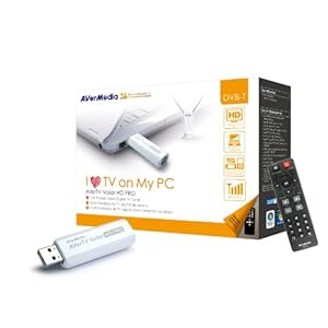

AverMedia - Volar HD Pro
http://www.amazon.fr...ils_o00_s00_i00
[872952.364033] usb 2-4: new high-speed USB device number 3 using ehci_hcd
[872954.063186] dvb-usb: found a 'AVerMedia AVerTV Volar HD/PRO (A835)' in cold state, will try to load a firmware
[872954.129292] dvb-usb: downloading firmware from file 'dvb-usb-af9035-02.fw'
[872954.443801] af9035: firmware version=11.5.9.0
[872954.448300] dvb-usb: found a 'AVerMedia AVerTV Volar HD/PRO (A835)' in warm state.
[872954.456488] dvb-usb: will pass the complete MPEG2 transport stream to the software demuxer.
[872954.465254] DVB: registering new adapter (AVerMedia AVerTV Volar HD/PRO (A835))
[872954.474546] dvb-usb: MAC address: 00:00:00:00:00:00
[872954.482946] af9033: firmware version: LINK=11.5.9.0 OFDM=5.17.9.1
[872954.489183] DVB: registering adapter 0 frontend 0 (Afatech AF9033 (DVB-T))...
[872954.497434] tda18218: NXP TDA18218HN successfully identified.
[872954.504176] dvb-usb: AVerMedia AVerTV Volar HD/PRO (A835) successfully initialized and connected.
[872954.524286] usbcore: registered new interface driver dvb_usb_af9035
[896665.209300] usb 2-4: USB disconnect, device number 3
[896665.239042] dvb-usb: AVerMedia AVerTV Volar HD/PRO (A835) successfully deinitialized and disconnected.
[896671.099319] usbcore: deregistering interface driver dvb_usb_af9035
[950089.535030] usb 2-4: new high-speed USB device number 4 using ehci_hcd
[950090.915371] dvb-usb: found a 'AVerMedia AVerTV Volar HD/PRO (A835)' in cold state, will try to load a firmware
[950090.940501] dvb-usb: downloading firmware from file 'dvb-usb-af9035-02.fw'
[950091.257854] af9035: firmware version=11.5.9.0
[950091.262337] dvb-usb: found a 'AVerMedia AVerTV Volar HD/PRO (A835)' in warm state.
[950091.270501] dvb-usb: will pass the complete MPEG2 transport stream to the software demuxer.
[950091.279310] DVB: registering new adapter (AVerMedia AVerTV Volar HD/PRO (A835))
[950091.288722] dvb-usb: MAC address: 00:00:00:00:00:00
[950091.298738] af9033: firmware version: LINK=11.5.9.0 OFDM=5.17.9.1
[950091.304961] DVB: registering adapter 0 frontend 0 (Afatech AF9033 (DVB-T))...
[950091.313244] tda18218: NXP TDA18218HN successfully identified.
[950091.319977] dvb-usb: AVerMedia AVerTV Volar HD/PRO (A835) successfully initialized and connected.
[950091.340199] usbcore: registered new interface driver dvb_usb_af9035
Le AVerMedia AVerTV Volar HD/PRO est compatible avec le vidéo station.
Heu ... c'est pas celle que j'avais déjà testé ? c'est passé inaperçu ?
